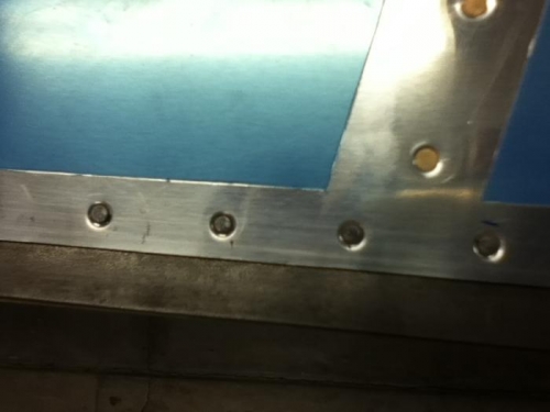

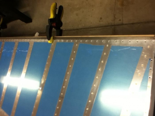

Removed clecos from angle aluminum and edge looks pretty straight. Maybe slight bow in middle ?
Going to place rivets with rivet tape and set rivets
Took an hour to clean out holes and recheck dimples.

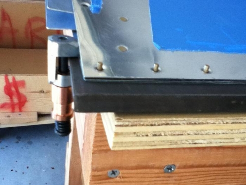

Rivets installed and back riveted! Used straight rivet head, borrowed from Ralph Cloud, to di initial set. Worked out pretty well.
All rivets back taped and ready to back rivet
rivets set 1/2 way in working across
all set.  No warping!
