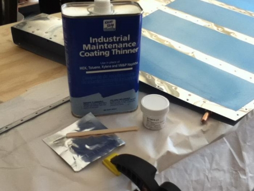

Brief Description:  Cleaned and scuffed trailing edge
Used scotch brite and scuffed trailing edge wedge and inside of trailing edge skin. Cleaned with a generic Industrial maintenance Coating Thinner (from OSH) that says its just like MEK.
Mixed up sealant and applied to wedge, both side. Messy.
Clecoed rudder and angle aluminum together.
Now wait two days (??) to set.
Ready to mix!  Solvent in back was cleaner

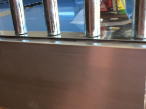

sealant squeezed out and cleaned off
Extra clamp at end to keep edges together
