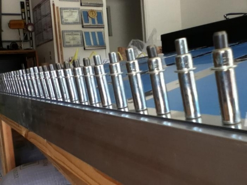

start the process of preparing the trailing edge for riveting. Drilling and clecoing trailing edge to angle aluminum.

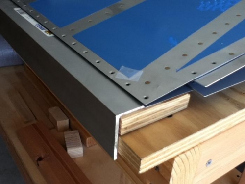

Drilled, deburred, and clecoed skin / wedge/ angle aluminum: everything looks straight with no puckers or waves.
Set up to drill holes
All drilled and clecoed
nice and flat / even / straight
