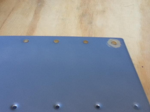

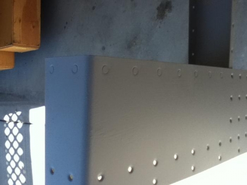

Redoing the first rivets on leading edge of counterbalance skin. Rivets not properly set. Drill out, re dimple, touch up primer, re rivet
primer pealed off drilling out rivet

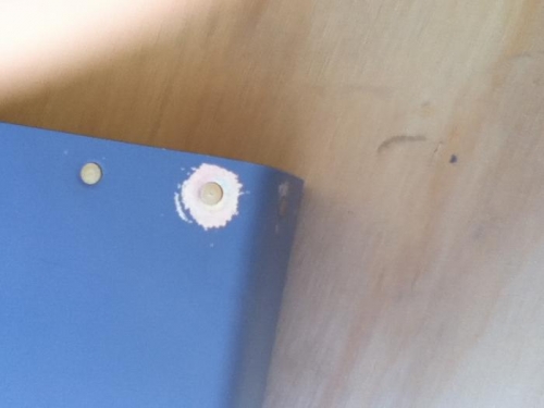

same other side
re primed!
