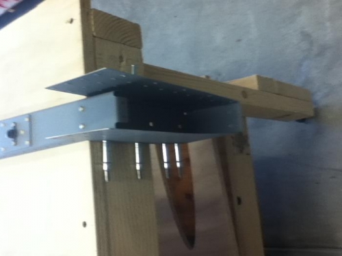

Brief Description:  Rivet rudder horn, and ribs to spar

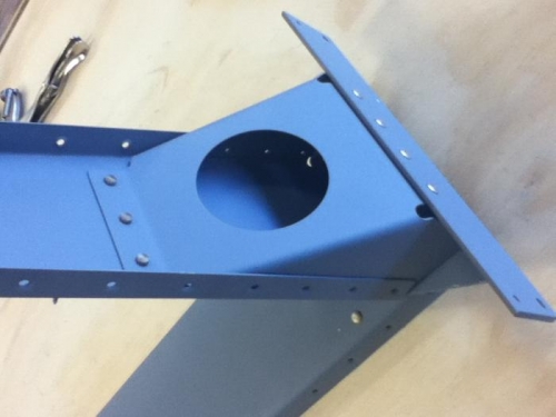

Rivet rudder horn / spacer to spar using 4704 AD 4-7 rivets
Rivet nut plates to reinforcement plate / spar with 4-8 (?) rivets - need to be longer
Rivet bottom rib to spar/reinforcement plate wit 4-7 rivets
Used LP 4-3 pop rivets to attach rudder brace (R-710) to rudder bracket. Used the last of these rivets so I placed and order to VAN s for 30 4-3 and 30 4-4 (just in case I need longer pop rivets later).
