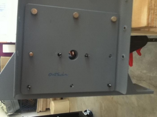

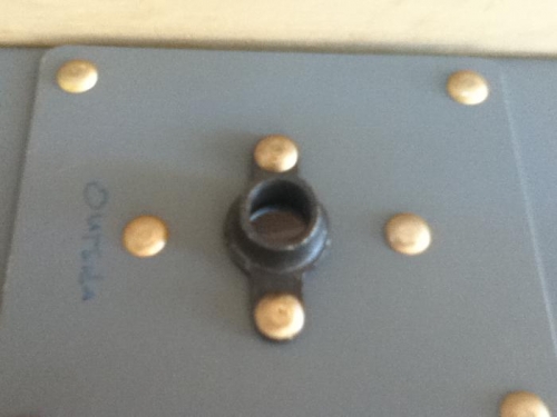

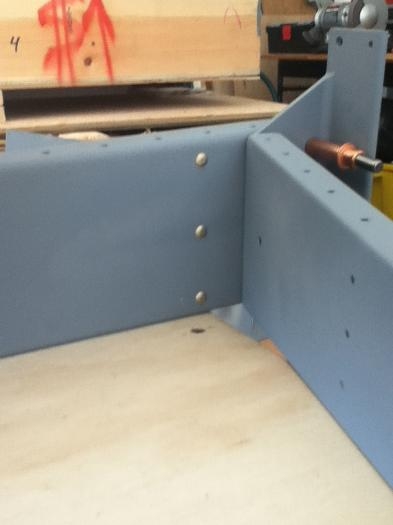

Brief Description:  Rivet nut plates to spar/reinforcement plates
rivet nut plates to top and middle reinforcement plates.
replace one rivet (4-5) with new on (4-6) because it was overdriven / too flat on the back.
Rivet top three rivets (4-5) on bottom reinforcement plate
