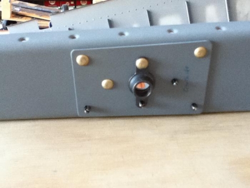

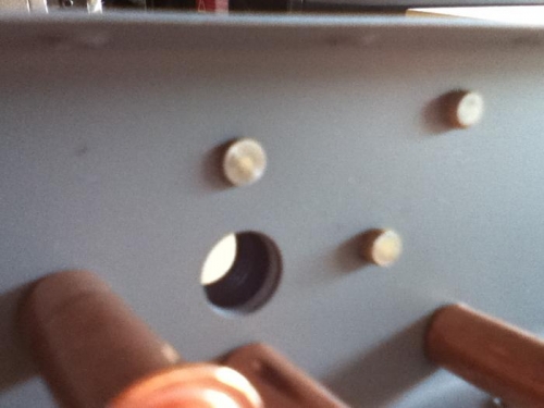

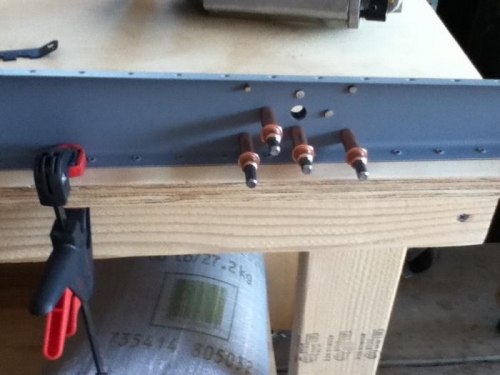

Begin riveting rudder nut plates to spar
Begin riveting the reinforcement and nut plates to main spar. Looks like the nut plates will need AN470AD4-.5.?? Calls for 4-4's. Rivets drive too flat
