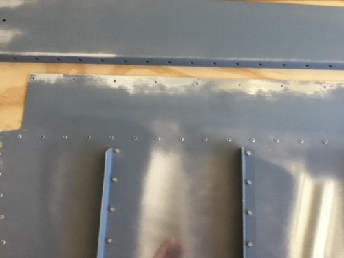

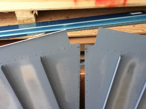

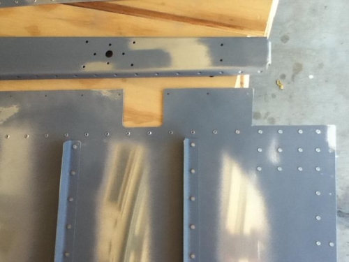

clean up and touch up primer
Main spar and edges of skin needed touch up, Self etching primer didn't do enough etching!
Now for it to dry.
Cleaned up work tables, light sanding. Getting rough and sharp edges from drilling / clamping.
Scotch brite scuff
wipe down with acetone
New Primer!
