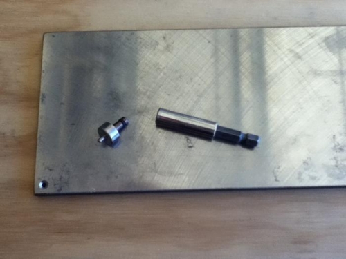

Think I have figured a way to dimple with die that I have until new dimple / shaft arrives.
Ordered parts from Aircraft Tool.
Used male Dimple Die in magnetic screw tip holder (used with electric drill to set screws) and back rivet plate with countersunk hole to create dimple.
parts on back rivet plate

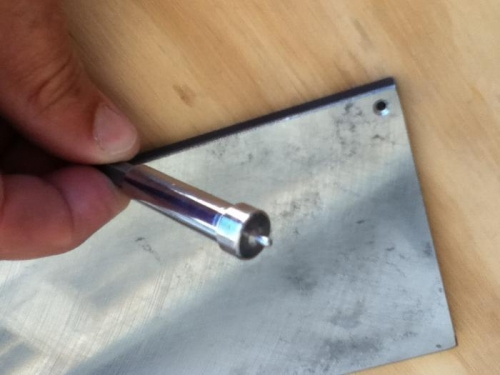

Great fit for Male Dimple Die!

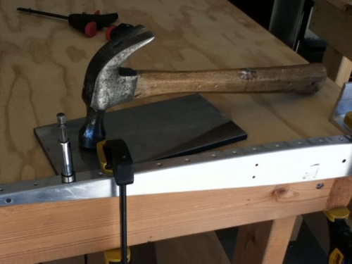

Clamped set up
Clamped set up
