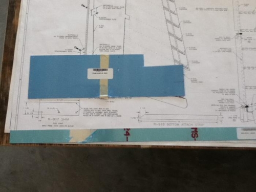

Brief Description:  Drill holes in Rudder Skin attach rudder brace and
Final filing / fitting of rudder stiffeners to spar. Drill out all rudder skin holes.
Trim rudder bracket , attach, drill out holes to #30.
Fabricate bottom attach strips from 1&1/8 T3 strip. This is the material that should have been used for rudder horn shim. Need to fabricate, fit, and drill R-917.
Ready to disassemble for deburring and dimpling
Same strip used for rudder horn shim
