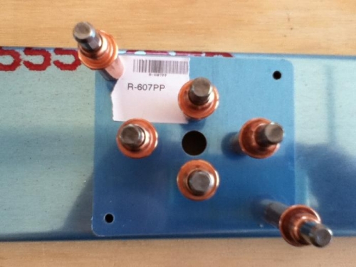

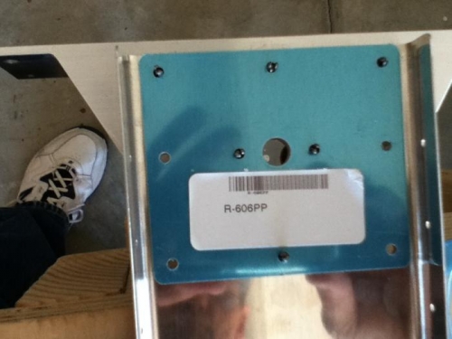

Fit rudder spar reinforce plates and cntr balance
Cleco reinforcement plates to spar and drill out to #30
Fluted the counterbalance rib rudder tip rib.
clecoed and drilled out to #30
