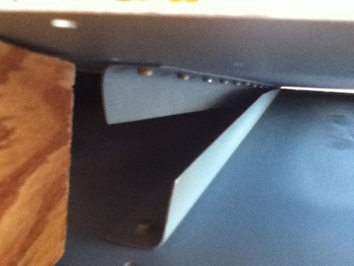

Brief Description:  back rivet stiffeners to skins
practice on scrap stiffener!
Rivets are small and soft - takes very little pressure / force to drive rivet.
One rivet head was only partially on back rivet steel plate so it bent rather than driving flat. Had to drill out, re dimple (to remove small bend in skin) drill out slightly and 'oops rivet it'. looks good on both sides.
