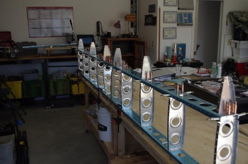

Brief Description:  Cleco, Drill to #30, mark all ribs

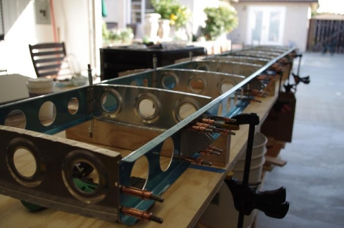

Clecoed all main ribs and nose ribs, checked orientation, drilled out 1/8 holes to #30.
Had to use long drill bit to get holes from the nose down, back spar was reachable with normal bit.

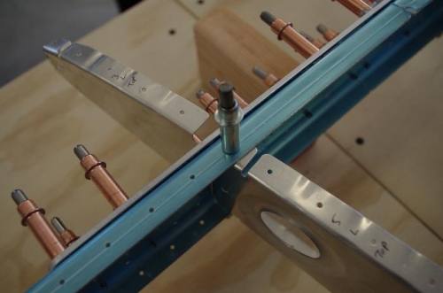

Marked all ribs, starting on the left, 1 L Top, 2 L Top (to 10 R Top) for main ribs, and 1 L top to 6 R Top for nose ribs.
Now I need disassemble and deburr ALL holes.
Drill from top with long bit

all ribs marked
all ribs marked
