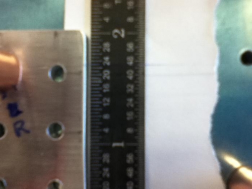

Re marked and drilled out 9 holes on each attach bracket and spend 30 minutes finding way to clamp to angle.
After attaching discovered that the match hole NEEDS 'Accurate Positioning'. Originally marked line at 1 5/8 inch (1 20/32 inch. Line appears to be very close but when drilling to bit wandered 2/32 low.
End Result - it appears that by using 1st attempt right bracket and 2nd attempt left bracket I get the required 1 20/32 measurement from the bottom of the bracket to the center of the hole.
wrapped transparent nylon thread around cleco, going over the top, and measured. At first the measurement of 1 22/32 made it appear that I was 2/32 high. HOWEVER the width of the cleco shaft is 4/32: subtract 1/2 of the with of the shaft (2/32) puts it , apparently right on.
Question is 1/32 off important IF the measurements are the same between the two brackets.
Need to check with tech support in the morning.
method to measure position
line 2/32 high - center is very close
