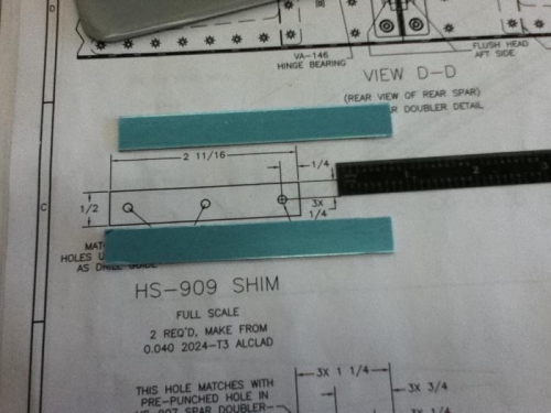

Brief Description:  fabricate HS-909 Shims
measured, cut, and marked first hole.
one hole slipped on one shim other looked OK.
installed on front rib and tried to match drill other two holes.
WAY off. Need to re make shims.
Too Tired today should not have tried measured and cutting and drilling.
Need to mark center line and then turn shim over and line up with hole on reverse side of spar.
