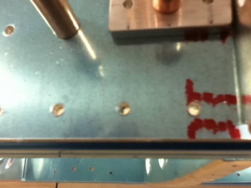

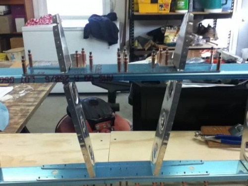

Rechecked all ribs, clecoed to front and rear spar. Checked placement of outer nose ribs. checked angle of inner ribs and nose ribs (11 d off 90). Discovered that attach brackets were originally positioned correctly. Checked, double checked, triple checked, checked plans again. I had them right to begin with. However a couple of the drilled out holes are not acceptable and I will be replacing the entire front spar. Holes looked oblong and over sized. may remake attach brackets for the experience
ribs trial fitted
ribs trial fitted
checking alignment
checking alignment
some holes oblong - bad drilling
