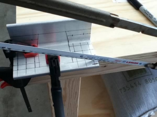

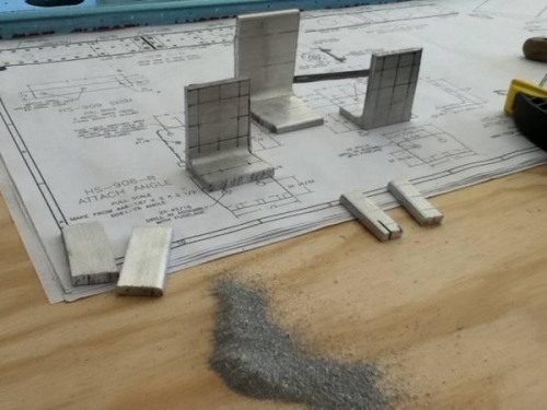

Marked aluminum angle with sharpie and ruler. Marked both sides. Rough cut with hack saw and angle clamped to table. Ended up with VERY rough edges and needed a lot of scotch brite on grinder to finalize shape and round corners.
mark with sharpie and ruler
rough cut with hack saw

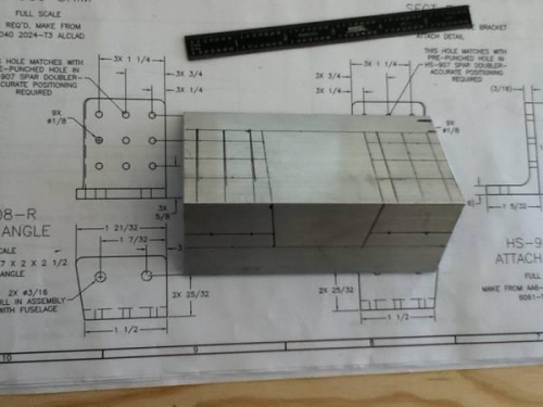

Basic shape - ready to grind & de burr
