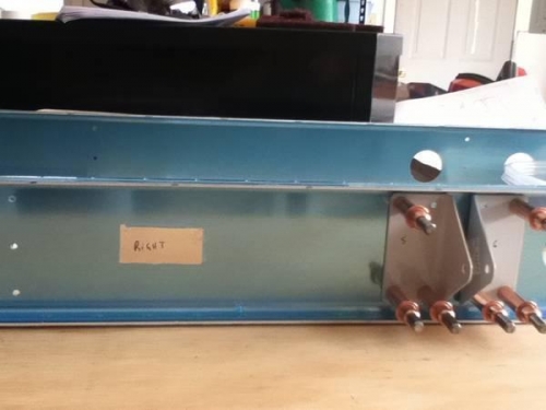

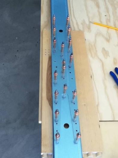

Clecoed the two HS-903 rear spars with the HS-906 rear spar doubler. Drilled out with #030 drill bit.

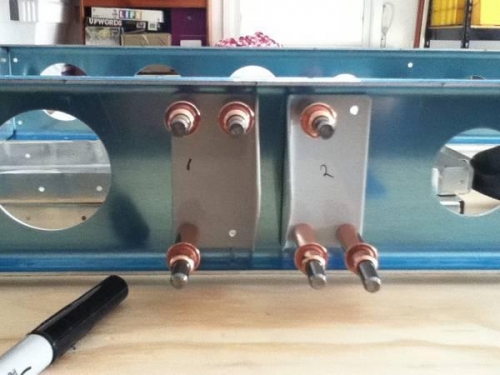

Attached 8 HS-912 outboard hinge brackets and enlarged holes with #30 drill bit. Had to cleco from back with small clecos because hinge brackets were powder coated and made it too difficult to use large (#30) clecos.
Numbered hinge brackets from left to right 1 - 8
Marked rear spar left and right.
Rear spar with doubler
Hinge brackets
Hinge brackets
Marked rear spar
Marked rear spar
