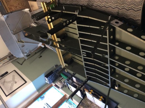

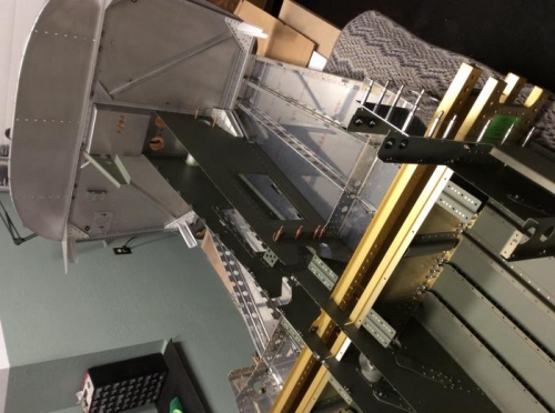

Brief Description:  Mate Fwd Ctr Section to Fwd Fuse & Bolt
Exciting time in the build at this point. Mated mid and forward fuselage assemblies. Asy is now rather large and parts went together nicely. Made sure to correclty position bottom skins. Loose assembled bolts on bulkheads as the parts will have to be separated and reassembled later after all final drilling.
