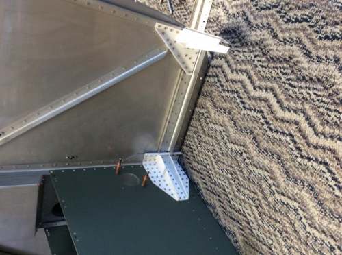

Brief Description:  Rivit nose gear tension, rib asy, firewall & Fuel
For section 4-8 riviting L/R forward rib subasy to firewall, used 4-6 rivits instead of 4-5 to attach nose gear tension fitting to firewall. Also m/c counterunk fuel bracket rivet holes to accept rib asy dimples. M/C countersink was not called out but clearly required F-1048C-1.
