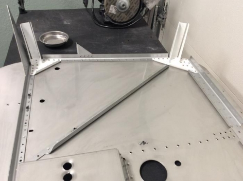

Brief Description:  Rivet bkts, M/C access tunnel rt/lt cover/re-enf.
Riveted upper/lower firewall brackets to firewall. Used -6 rivets instead of -5 to make sure of gauge rivet gauge fit. -5 rivet would not pass rivet gauge for height even after making sure components were fully nested in dimpled surfaces. May have something to do with the amount of coating supplied on the upper and lower brackets.
