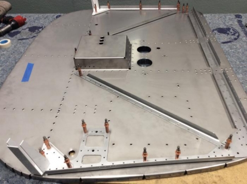

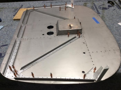

Date:  10-26-2019
Number of Hours:  6.00
Manual Reference:  27-2-7
Brief Description:  Rivet firewall components to firewall
Substituted AN470AD3-5 rivet for nutplate on upper right angle. I did this because I had countersunk the back of the support when it should not have been (for the nutplate that goes on the front of the firewall). Also used 4-6 instead of 4-5 rivits for tri-gear brake bracket WD-1002-L-PC & R-PC & WD-10030L-PC & -R-PC to firewall.
