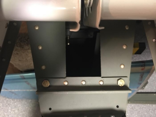

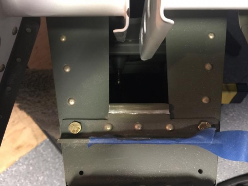

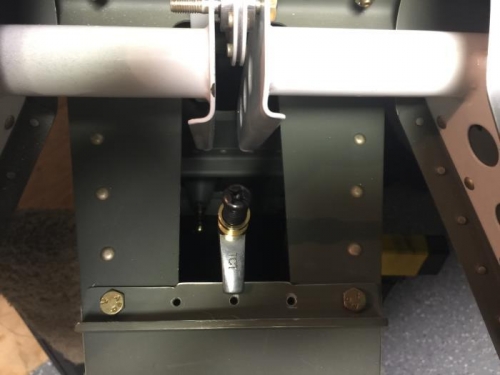

Elevator Stop Bkt. Trim to correct dimension per S
Remove VS, remove elevator stop bkt, refinish to allow 26 degrees up and 27 degrees down. Countersink VS bottom teo holes for #10 screws
