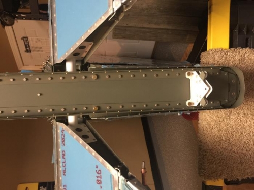

Brief Description:  Make 4 1098 shims, drill VS attach bolt
Drill VS attach hole/bkt, buid 4 1098 shims, match drill HS attach bars and insert hardware. Clamp block and measure for squareness of HS. Extremely close to perfectly square after adjusting.....about 1/16 off.
