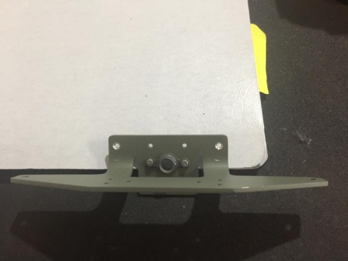

Brief Description:  Disassemble Rudder, Countersink New Rudder Horn
Completed countersinks on rudder horn after receiving new part. Old part had counterunk two holes slightly deeper than I wanted so ordered a new part to replace. Reassembled enough of skeleton to align holes and match drill to bracket/spar. Deburred holes.
