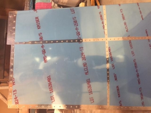

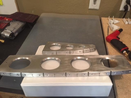

Brief Description:  Countersink, Dimple Skin, Counter Sink Spar
Machine countersink VS rear spar flanges, dimple VS skin, mark VS skin and ribs for holes to avoid countersinking.
Also learned how to operate pneumatice riviter, squeezer, DRDT2 and back rivit.
VS Doubler and Spar Countersink
