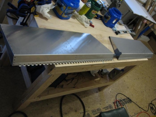

I deburred the remaining elevator skin, and did some final clean up on some handling scratches in the ribs and skins. All parts were first sprayed with "Goof-Off" to get rid of any measuring marks or lablels. After that dried everything was wiped free of dust, metal shavings or other particles and blown out with compressed air. Finally I wiped eyerthing down with denatured alcohol to remove skin oils and other contaminates as much as possible before assembly.

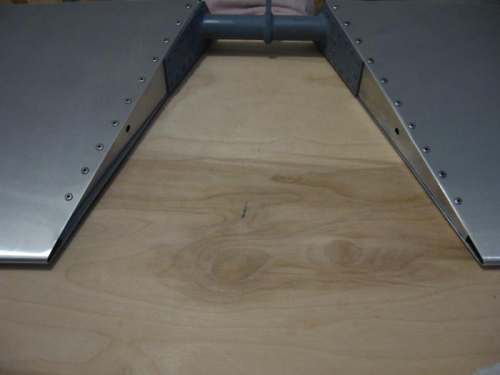

I clecoed everything together, and started riveting! Everything lined up, and the elevators sit flat on both sides following riveting, so I don't think and twist or other warping crept into the process. I didn't like that to set the proper 78" length, I had to leave a little overhang on one side (visible in pic 2 on the left side), but the factory said that's not usual or problematic, so there you have it.

Completed Elevator Assembly
Note Overhang on the left skin...Purely Cosmetic and Common According to Sonex
