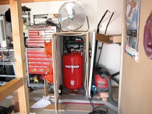

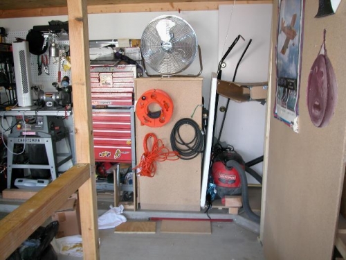

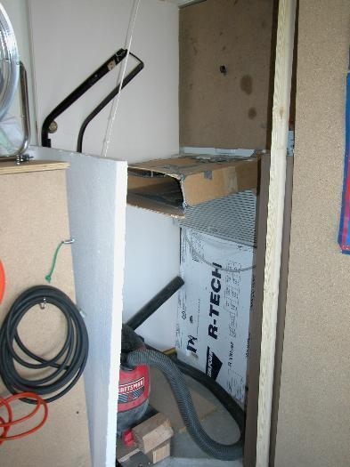

Remember I told you the garage get hotter then hell in the summer. Well, I made a door where the side door of the garage is located and put a 16000 BTU/120volt AC in it. At least when the outside temperature in 110+, the garage is a cool 85 degrees. Pictures 2 and 3 are the compressor. I build a ply wood box with carpet inside and put the compresor inside. Since the unit is a non-oil unit it can get noisey. With the compressor in the box, the compressor sounds are greatly reduced
Air Conditioner in the corner of the garage.
The compressor is in the box.
Compressor in noise suppression box.
