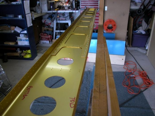

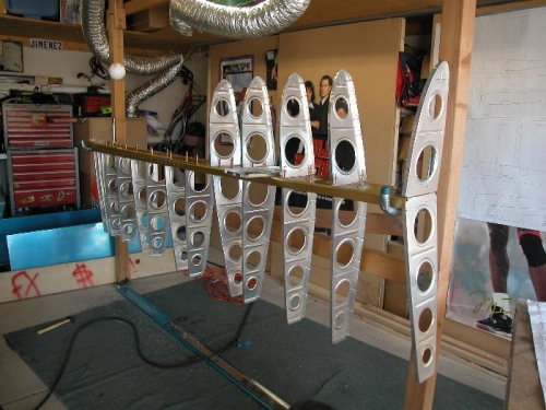

After fluting the ribs its time to set them up on the spars with clecos. All the holes from the ribs to the spars have to be match drilled. Double check the alignments of each rib because some ribs point a different way then others. mark eack ribs so you can put them back in the same spot for final assembly.
Main right spar
Main right spar
Matchdrilling and clecoing the ribs
all lined up with W-707 spar
