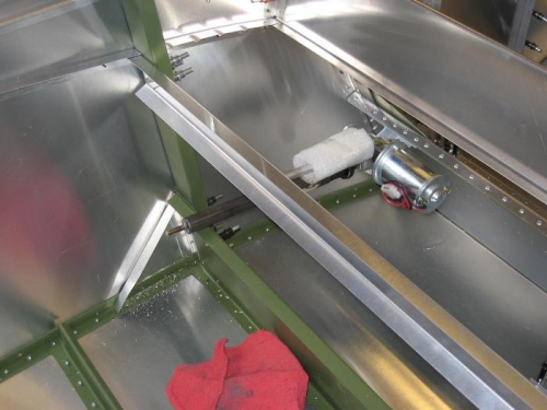

Finished drilling to A5 on center arm rest.
Prep and Zinc all "L" 's for center arm rest. (which doubles as a tunnel for torque tube) Also a path for elevator cables and rudder cables.
Removed seat back to rivet side braces that can not be riveted after installed. Have re-installed seat back. (This was a bear! )
As expected, I need to rivet a few things on fuse. that can't be done later. (Lots to rivet from bottom of plane.
