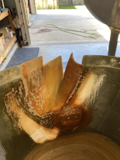

Brief Description:  More fiberglass work on the intersection fairings
Instead of just glassing the outside of the fairing to the wheel pant I decided to cut around the inside paremeter and glass both out and in for added strength. Then I used micro to blend the area on the outside. The final product came out very nice.
