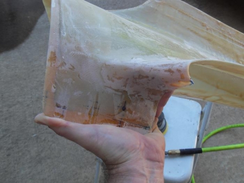

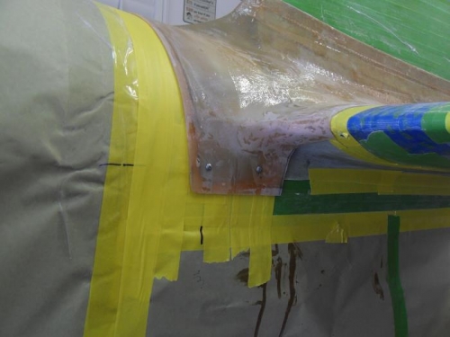

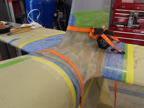

Started in on the tedious glass work for the empennage fairing. I purchased mine after market from Fairings etc. The fit out of the box was pretty good but with the 1/4" left offset of the vertical stab I had to cut and add 9oz cloth to get it perfect. At this point Im about 1/2 way there.
Initial fit
Initial fit
Had to adjust and add glass for the offset
drilled and tapped for a No6 screw
