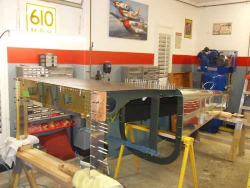

Brief Description:  Joined the tail cone and center section together

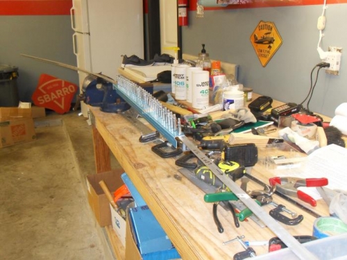

I saved bending the longerons until they were ready to install due to space considerations. The first one was a learning curve. (No pun intended). The second went a lot easier. The biggest advice is check the opposite plane to the bend to see if it's curving off of a flat plane. There is no way to get the correct curved path if you don't also chech for a flat plane along the way.
Completed the bend on the longerons.
Initial join of the tail cone and center section.
