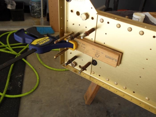

For the last two days I completed the Center section per the plans. The hardest part was inserting the close tolerancce bolts to match drill the side supports. I recommend lots of axle grease and patieence!
Worked for the last two days completing the center section carry through
Match drilling and riveting the center section
Inserted the 1 7/16
Inserted the 1 7/16" thick spacer block
