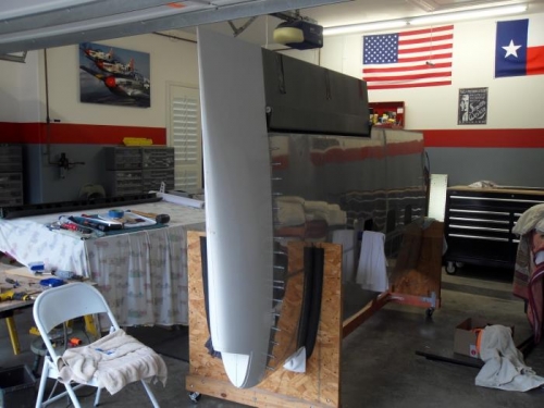

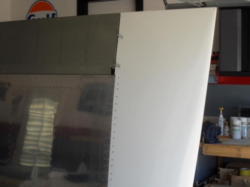

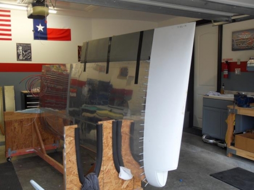

Brief Description:  Riveted on the top hinge
After cleaning up the edges, counter sinking the fiberglass spacer and dimpling the wing portion it was time to rivet the hinges on. Wanting added strength I mixed up epoxy and smeared it between the hinge the spacer and the wing. I then riveted the hinges to the tip and wing. It came out great and will allow quick removal if necessary.
