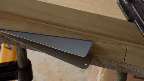

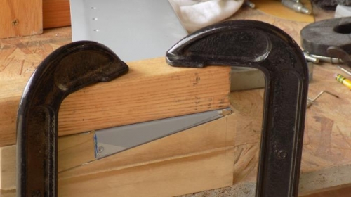

Brief Description:  Trim tab continued

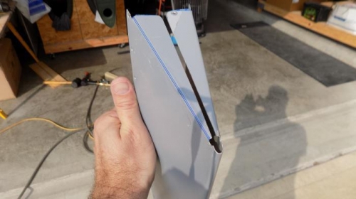

After clamping the blocks in place with the carpet tape to hold them I used a 2 x 8 block of wood cut about a foot long to put the initial bend on the tab. This bend was probably 75 deg or so. I then used a flush rivet set like Vans says to do and with the pressure turned down low tapped it to a crisp 90 degree bend. Image 3 shows the final product. I'm going to cut this tab and try it one more time just to be sure I can get it before trying it on the third tab thats on the way from Vans at this time.
tab clamped in place with the carpet tape between the top piece of wood and the tab
beautiful 90 deg. bend and finished by using a flush rivet set to tap the edge
Both ends bent
Both ends bent
