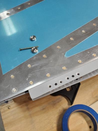

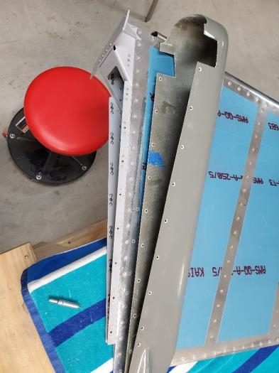

Installed nutplates and countersunk bottom rudder fairing. I had to use the tight space dimple dies to get the last two nutplates on each side.
Tight space dimple set from CleavelandTools
Nutplates installed and fairing countersunk
