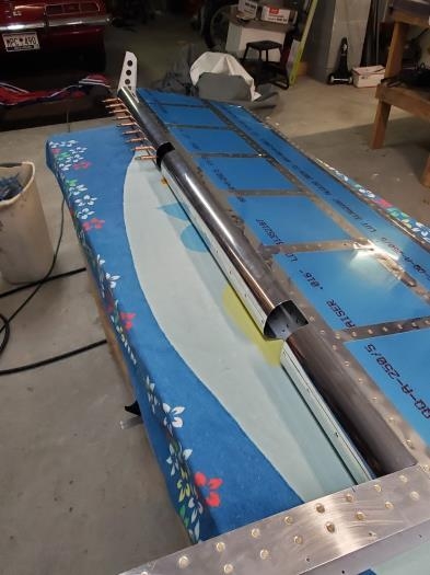

Brief Description:  Rolled leading edge of right elevator
I rolled the leading edge of the right elevator today. I used a slightly larger diameter pipe to see if it would make it easier to match up both sides. It didn't make much difference in my opinion. Once they were rolled I riveted them together with the pop rivets but since I had to drill out so many on the left elevator I didn't have enought to finish the right side. I ordered more from Van's along with some K1100-06 nutplates that I'll need for the flush mounted access panels in Ch 10.
Right elevator rolled and riveted
