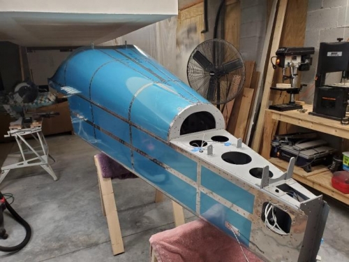

Brief Description:  Finished Ch 10

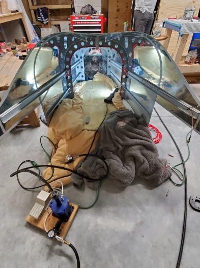

Mike and John Stoll (a fellow RV builder) came over and helped out today. Finished riveting the right side skin and top skin which completed Ch 10. We had a tough time getting to the top two 470AD4-4 rivets in the bulkhead with any kind of squeezers. We ended up using the offset cupped set in the 3x gun and tungsten bucking bar. Mike was able to reach the rivet with the gun while I crawled inside again to buck the backside.

Pillows and blankets to support me inside while bucking
Ch 10 Complete
Ch 10 Complete
