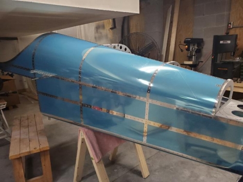

Riveted left side top skin to aft fuselage. Used AD3-4.5 rivets for all rivets along the F1418 longeron. The 4s seemed a little short. I also inadvertantly dimpled the #27 hole in the bottom right corner thinking it was a #30 hole. I used a flat set in the manual squeezer to flatten it out.
Left side top skin attached
