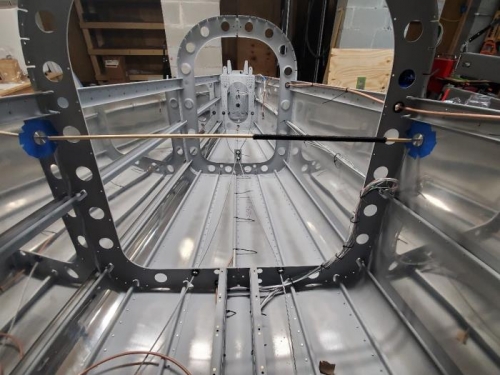

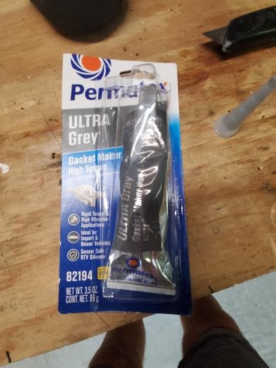

Installed static ports on both sides. Taped off the area, then sanded with 150 grit aluminum oxide sand paper. Used silicone RTV to set the ports in place and a dow rod to add some pressure while they set. Will run the tubing once the silicone cures.
Taped and sanded static port area
Permatex RTV used to install with dow rod to hold in place
Permatex silicone RTV
