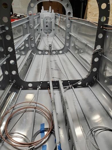

Brief Description:  Ran cables and wires. Prepped, dimpled and primed
Ran the coax cables (WH-00014 and 00015) and secured them with zip ties to the J-channels. Began prepping the pieces for the aft deck. Edged, scuffed, dimpled and primed those pieces. Also checked the two wires I had pinched earlier when riveting the side skins on. They were fine, no resistance in the wires.
Cabling run with snap bushings installed
