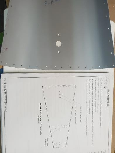

Brief Description:  Finished bottom rivets and enlarged holes
Finished riveting the F1478 bottom skin to the longerons. Enlarged 3 holes on F1479 with a drill bit for the #12 holes and a step drill bit for the 9/16 hole. Dimpled the F1479 skin and added the AD3-3 rivet to fill the hole. It's not used on a -14A, only the taildragger model.
Enlarged holes in F1479
Pilot hole filled
Pilot hole filled
