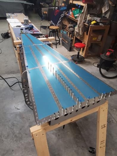

Brief Description:  Riveted bottom skin

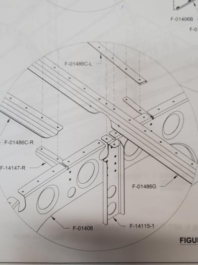

Riveted bulkheads and battery box. Used 3x rivet gun with mushroom head and tungsten bucking bar. The plans called for AD3-3.5s on all bottom skin rivets but there are a few spots that I felt needed AD3-4s. It's basically where there are 3 layers of aluminum instead of just 2.
One more row to buck
6 places I used AD3-4 vs. AD3-3.5
From the manual, the parts I used 3-4s on
