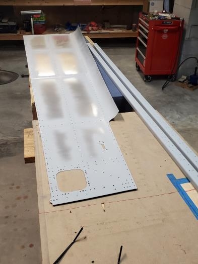

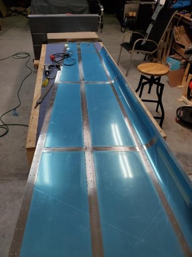

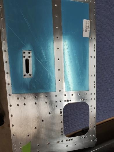

Brief Description:  Prep work on skins
I got on a roll with burning the vinyl off the other side skin today so I knocked out the top side skins too ((F1474 L&R). This is painstakingly slow work but necessary to keep the scratches off the surface. I then deburred and smoothed the edges for the right side skin and dimpled all the called for holes. Primed both side skins and both longerons (F1418) as well. Tools used...file, hole deburrer, 1" 3M scotchbrite wheel on a angle grinder, soldering iron, pneudraulic squeezer and DRDT2. As with the left side, there are a few holes that don't get dimpled...4 #30s near the bottom corner and a few #27s (2 on the top edge of the inspection window and all of the ones on the top edge that will receive nutplates.
Prep of side skins and top side skins
Smoothed with scotchbrite pad and dimpled
Primed with Grey SEM self etching primer
