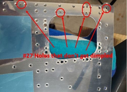

I finished dimpling some of the #30 holes in the side skins but did not dimple some of the #27 holes. There are 2 in the plans for the flush mounted plate that don't get dimpled and then all of the center nutplate holes along the top edge of the F1473 side skins are size #27 so I assume they don't get dimpled either.

#27 Holes
#27 Holes
