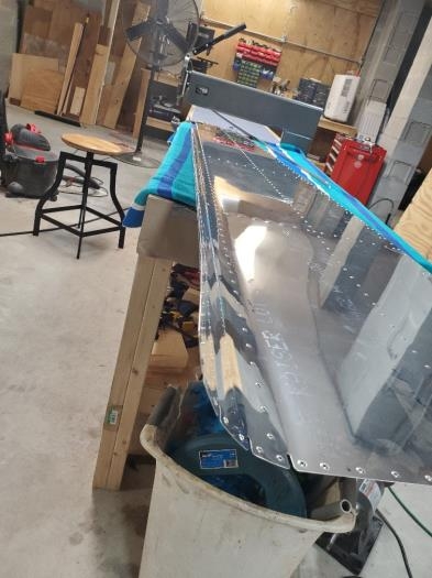

Brief Description:  Dimpling side skins
Dimpled side skin F1473L with DRDT and numatx squeezer for the curved edge. Also used a reduced diameter die for the bottom edge because I broke the edge per the instructions to get a tighter fit once it is riveted together. Not sure if it will turn out correctly though. There is a lot of deformation along that edge as all the dimples causes the edge to curl a little.
Bottom edge of side skin dimpled
