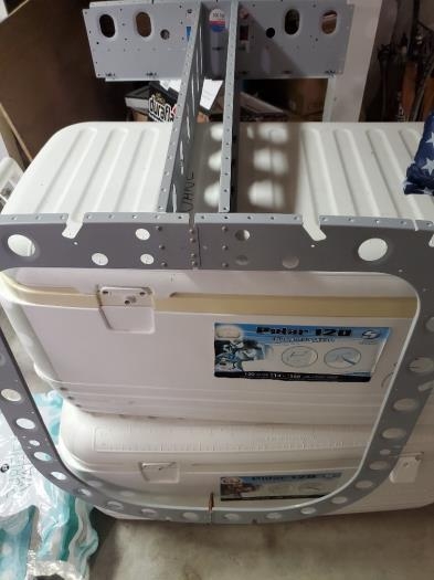

Riveted F1407 to the bellcrank assy. One rivet on each rib was tough to get to but was able to find the right combination with the numatx squeezer and yoke. It's the top rivet on each side. The nutplate is in the way so the yokes that require dies on the top wouldn't work. I used a 3" that was thin and flat on top with the 470 die in the ram of the squeezer.
F-1407 riveted to bellcrank assy

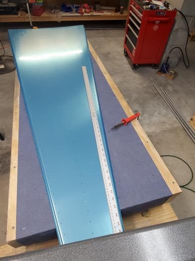

Bottom skin
Bottom skin
bottom skin
bottom skin
