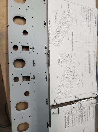

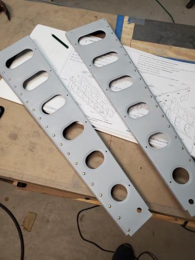

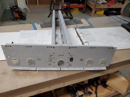

Followed instructions on Pg 10-12. Dimpled all the nutplate attachment holes and nutplates. Used small diameter dies for the nutplates. Primed all the parts then assembled the bellcrank assemblies to the bulkhead. I was able to use the numatx squeezer with a variety of yokes to reach all of the nutplates and bellcranks to the bulkhead.
battery angle and bellcrank ribs assembled
Nutplates installed on bulkhead
All together
All together
