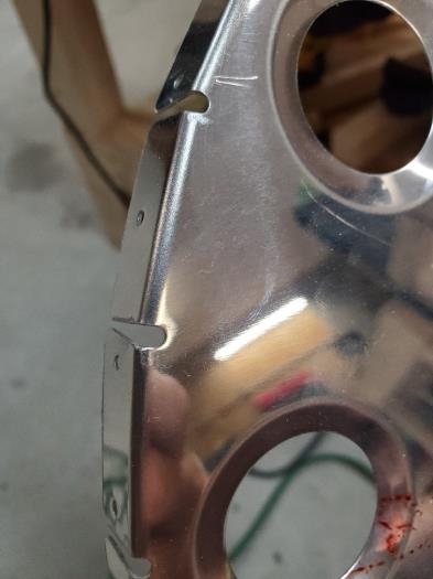

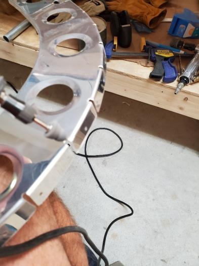

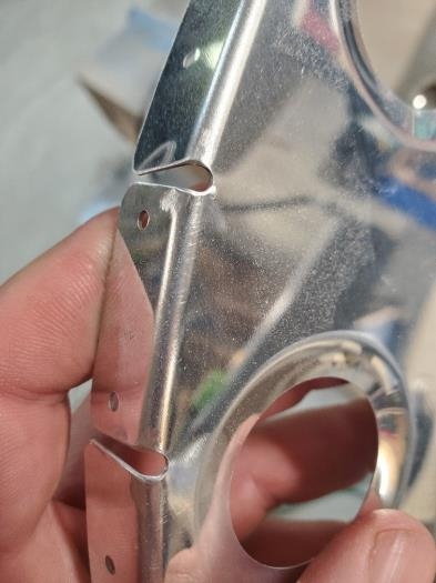

Rounded the faceted corners of the F-1407 and 1408 bulkheads using the dremel with the wedge of scotchbrite. This wedge was fabricated from the 1" scotchbrite wheel from Cleaveland Tool.
Faceted corners
Faceted corners
Dremel with scotchbrite wedge used to round faceted corners
After faceted corners were rounded
